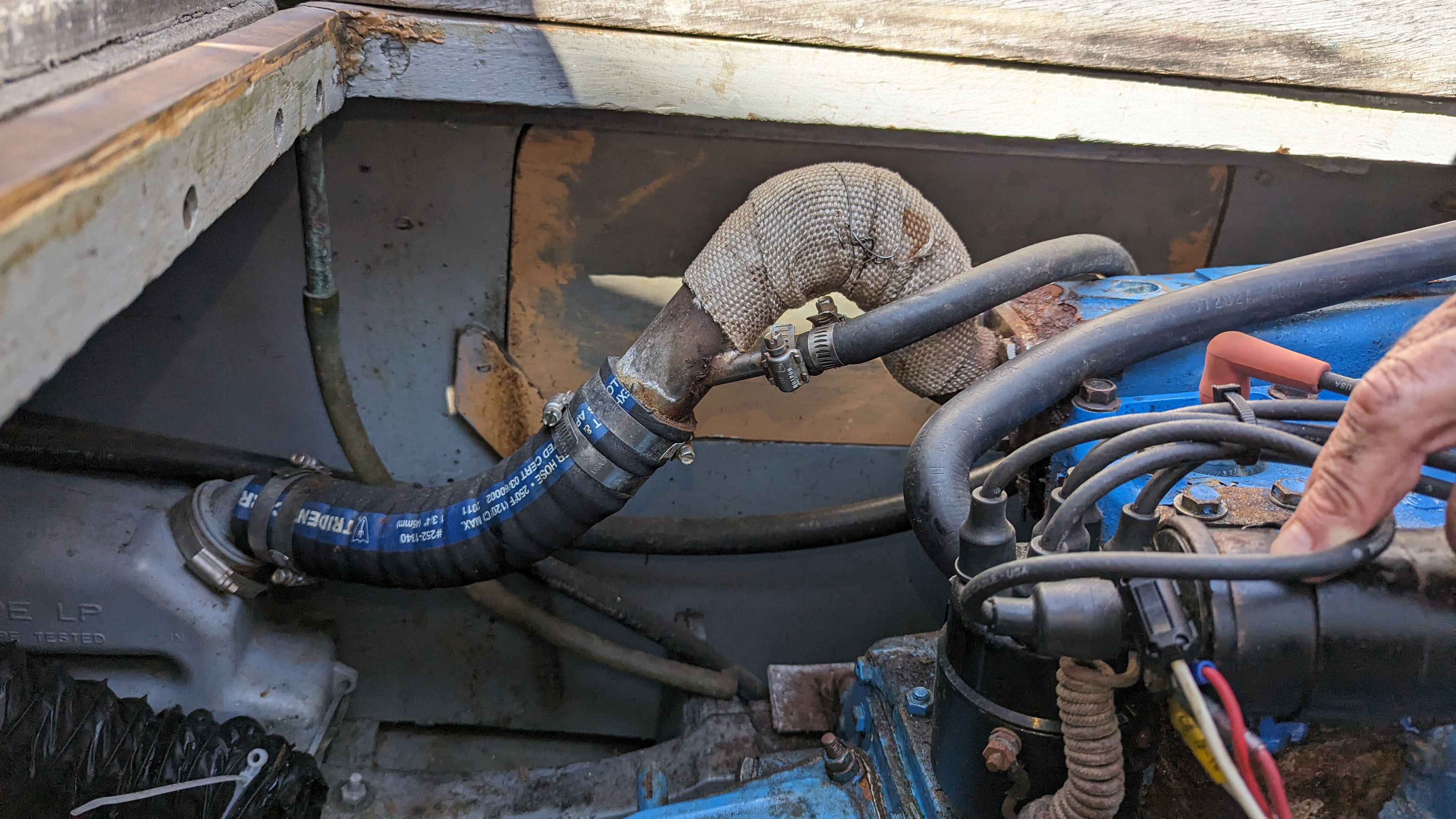

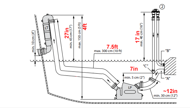

My conclusion is that my exhaust system is not correct. I have a 12 inch hose from the exhaust riser to a water lift muffler. The output goes to a hose that goes to center high near the transom. Maybe that is too high. Maybe I should run it in a more risky location.
The history is that the boat came with a standpipe system. 25 years ago I had the boat surveyed and the exhaust pipe failed. Svendsens replaced the entire exhaust system with the water lift and ran the outlet hose just under the toe rail. I flooded the engine twice by putting the rail in the water and changed it to where it is now. The system I have meets all the Vetus specifications but some are right at the minimum and some right at the maximum. Is anyone here an expert on exhaust systems? I could use some help on what the critical dimension I should increase or decrease.

Just thought these images from one of your older posts would be helpful to someone making suggestions.
