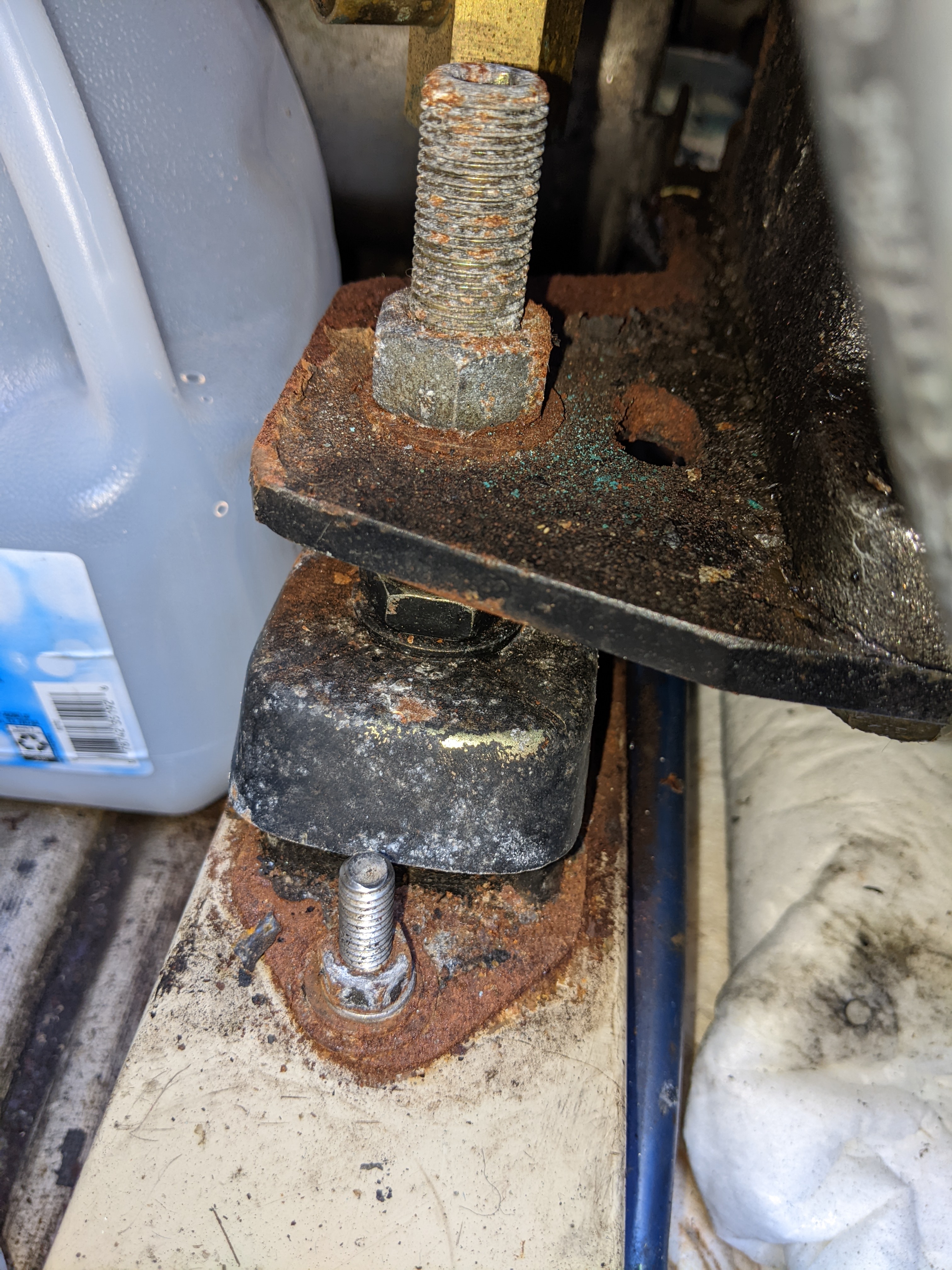

These engine mounts are on our 1978 Cal 2-25 with a Yanmar YSM8 inboard. Anyone recognize the mounts used here? The stud is 5/8", arount 4.5" tall overall, with mounting bolts 4" apart. I believe they may be Vetus but it would be nice to have a second set of eyes look at them, especially from others familiar with Cals. I had planned on replacing them this past week, and thought I was smart by buying Yanmar mounts, but the measurements were way off once I got to the boat. That was the moment I realized I was not so smart by not referencing measurements and photos more closely prior to.
Additionally, does anyone have a recommendation on engine mounts to use? I've come across Vetus, Barr Marine, Bushings Inc, and maybe one or two others with same measurements as the current ones.

For the pictures they do look like Vetus mounts, but I've not used Vetus so it's just a comparison of pictures.
