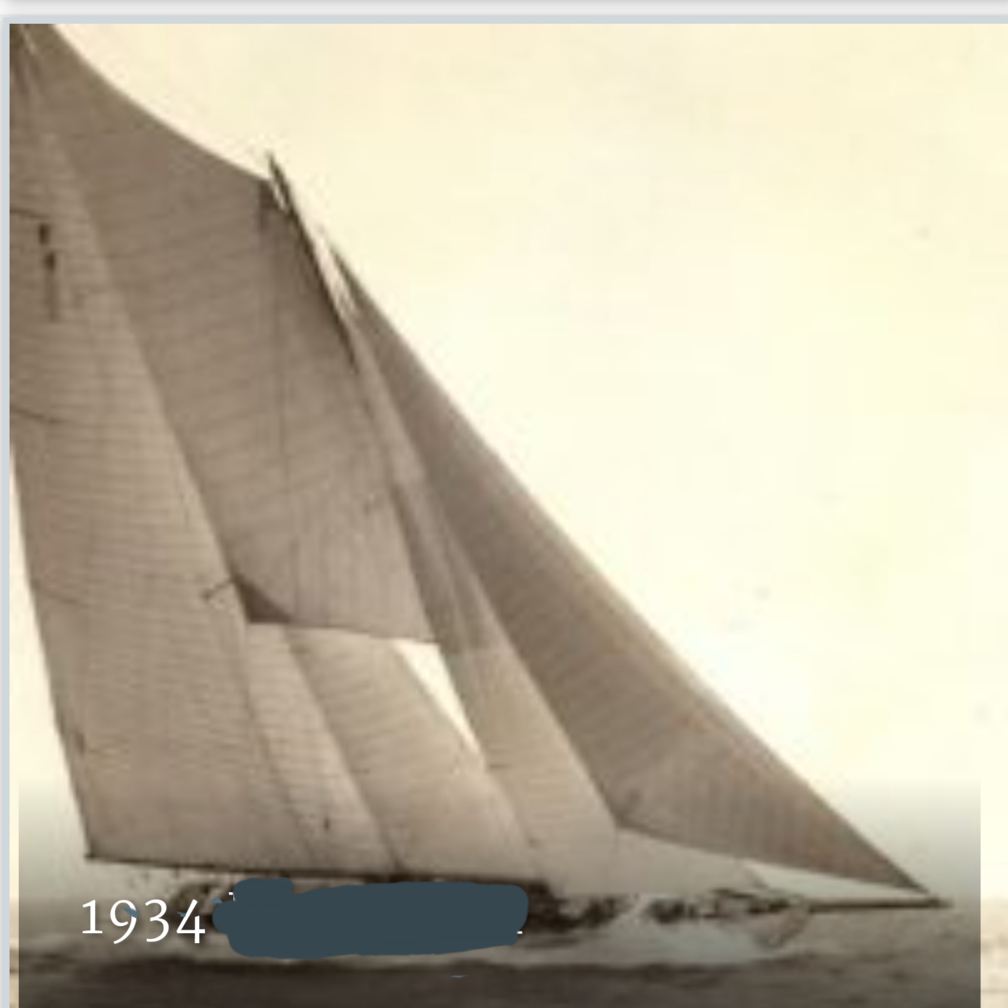

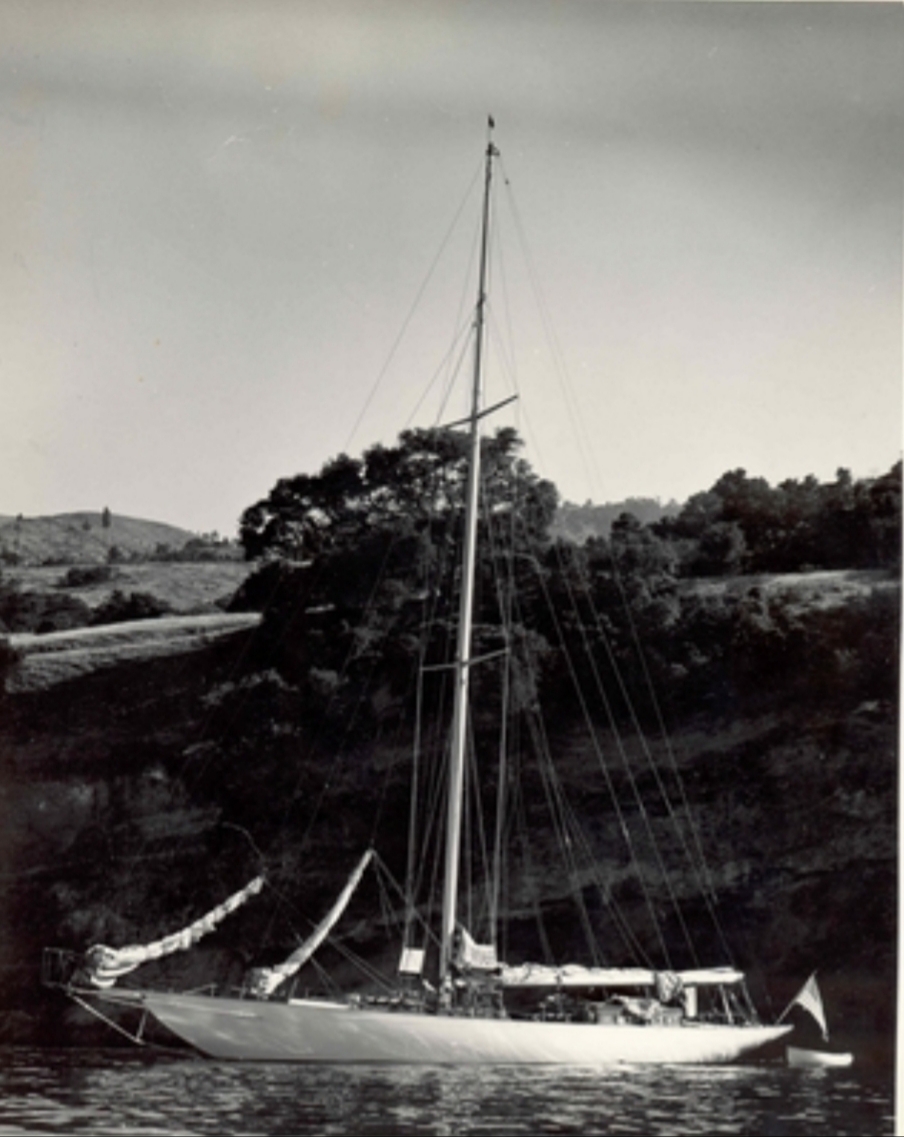

OK. That brings a whole different set of circumstances into play. If the PO changed to a higher aspect ratio rig it is likely that the center of effort moved higher and further forward. Without changing the mast step a way to compensate for the extreme lee helm would be to rake the mast to move the center of effort further astern. Hopefully the PO consulted a naval architect to get it right. Most boats especially Lapworth's do better with a slightly weather helm The angle of the rudder on the wind actually helps you make progress up wind. If you move the CE too far forward you get a lee helm. That would mean your rudder would be angled towards the lee side in order to compensate and this would to some degree pull you down lower on your intended course. If there have been changes to your rig and you don't have any documentation, before you change anything, you need to get the boat out and sail it. When working with a unknown rig you will have to tune it by the way the boat performs. Changing rigs is not a problem unless your class racing. As long as it's done right. Dad used to sail a schooner rigged M class. The owner bet another cutter rigged M class that if he couldn't beat him in a race. He said if he lost a 3 race series he would change his M class to a cutter. They only ended up racing one of the series but the schooner lost. The owner hired a world class naval architect and the boat was redone as a cutter. These guys my dad sailed with used to do things like that. Later the owner changed it to a ketch. If done properly changing rigs is fine but if done wrong it can make for some unpleasant sailing....As a schooner.
As a cutter.
Dad said he missed the gollywobbler but the cutter was easier to sail well.
