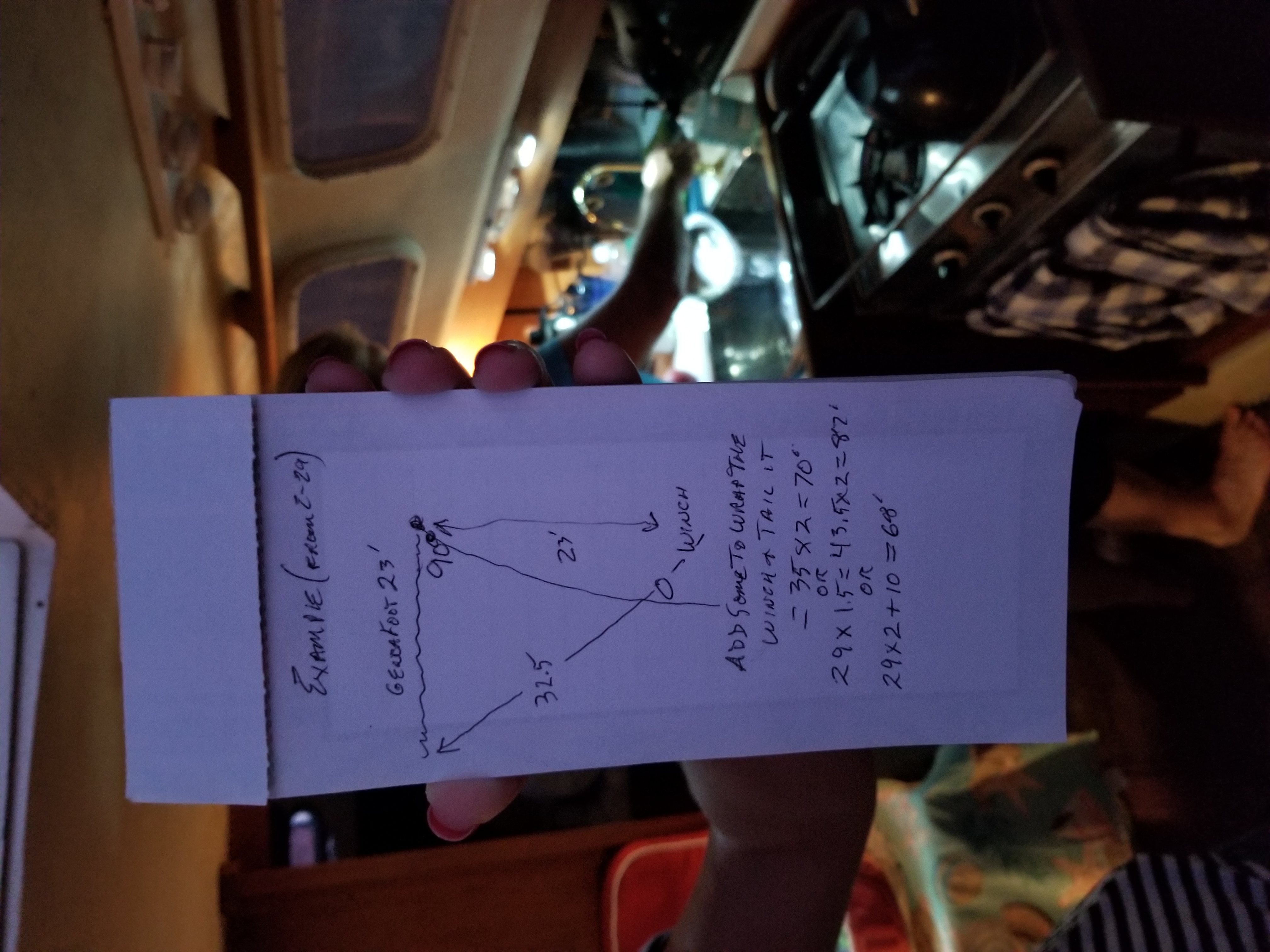

As a general rule of thumb we usually went the length of our boat + 5 for each sheet. So Total Line would be 2 times the length of your boat + 10 and put a bend in the Middle with a snap shackle. We didn't change sheets we just changed jibs. this was just rule of thumb it wouldn't hurt to measure the foot of the Genoa the distance from the head stay to the winch and do a side angle side calculation to get the length of the line. You know, 90 degree angle math.
Thanks, Randy. The general 1.5 x length of your boat equation seems excessive. I like your equation better. I figured 75’, so that’s 1.6 shorter than your calculation. I doubt I’ll ever use a genoa around here, but I will probably add a furler at some point.
