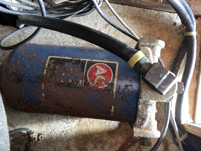

Cal 34-III Westerbeke 30 fuel filter
Can anyone identify this or know if it is the original? I want to buy spares.

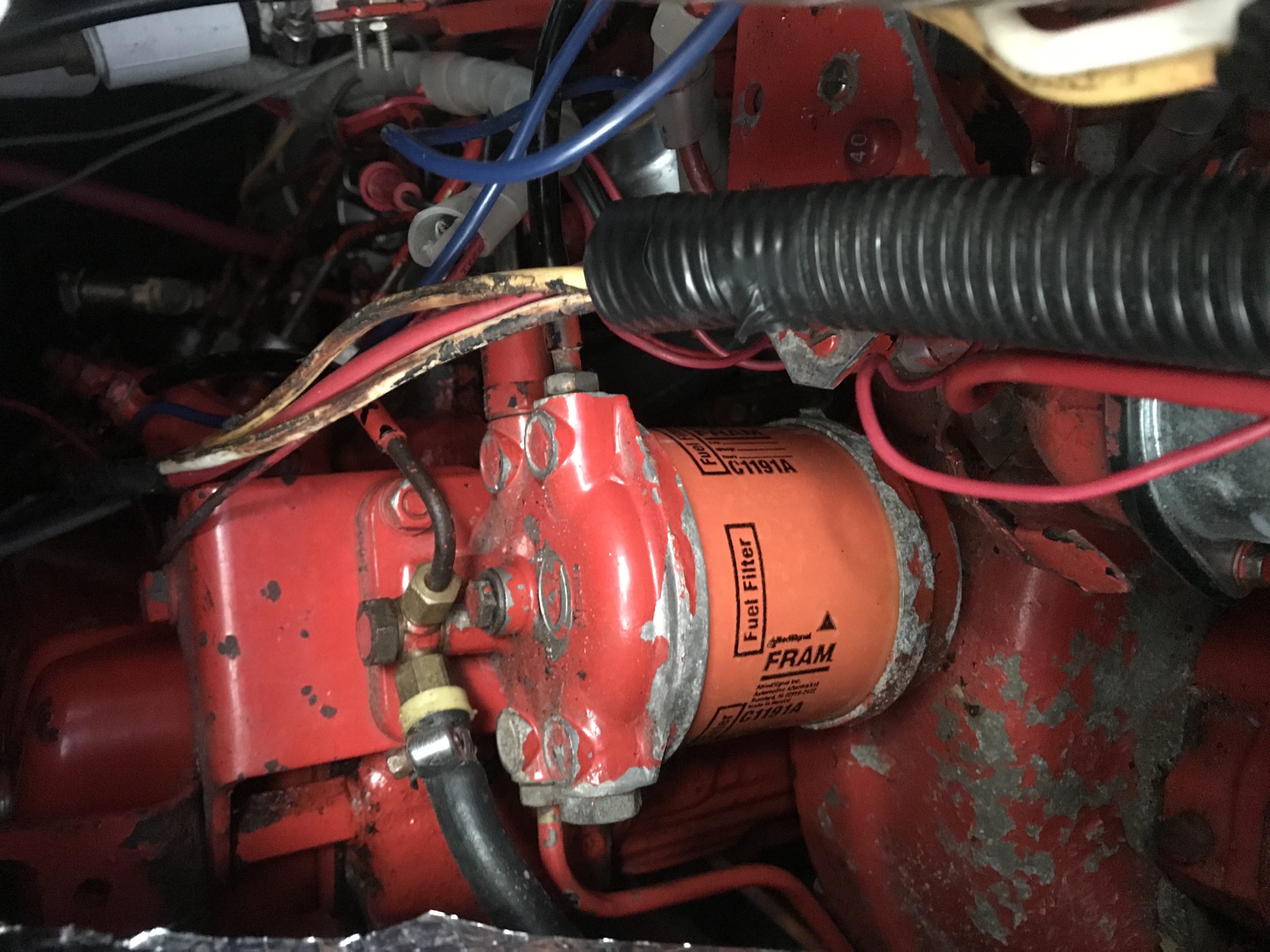

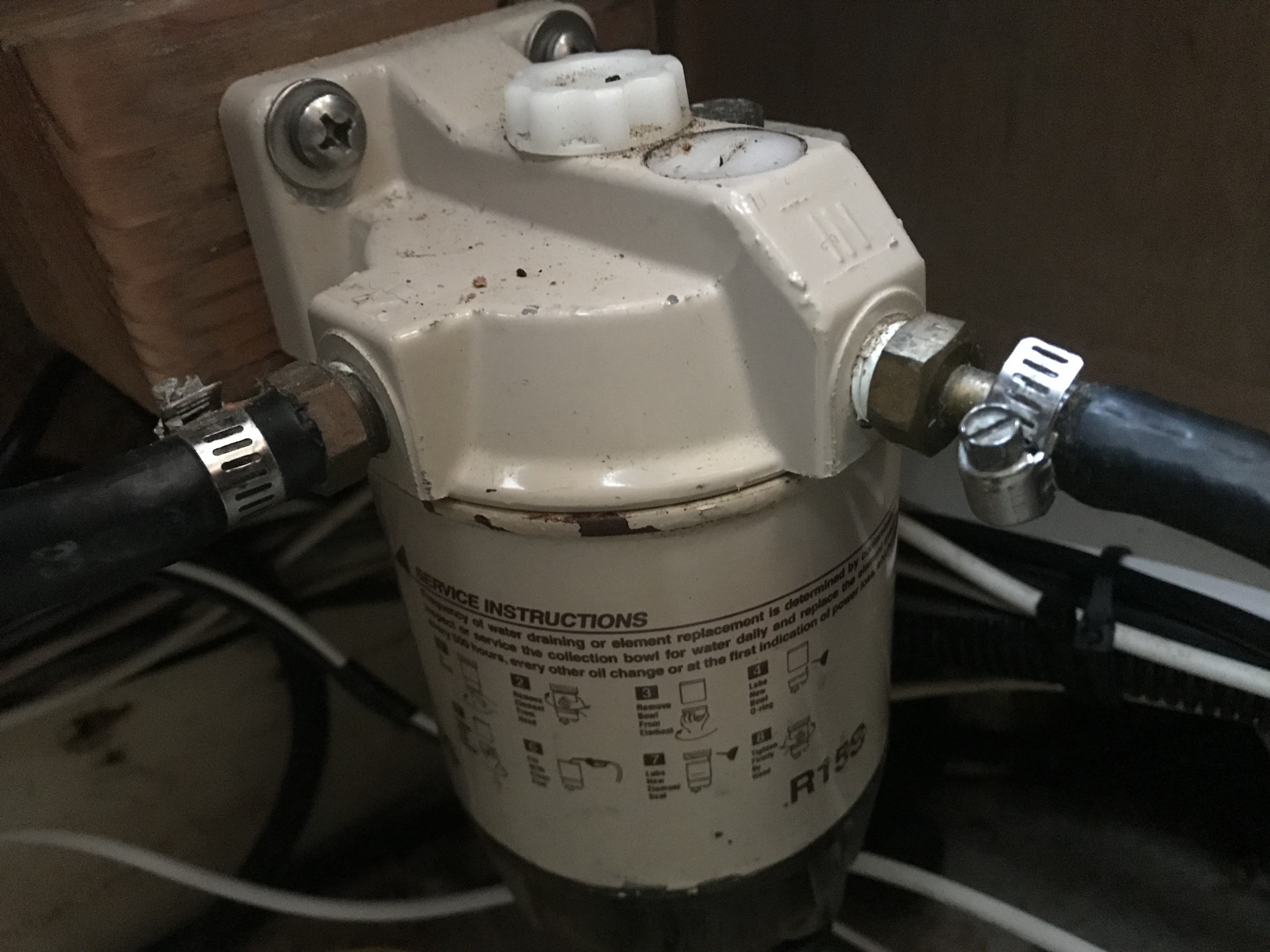

The filters I have on my 79' Westerbeke 30 are:
Racor (primary) 15S
Fram (secondary) C1191A
Bob

Thanks, Bob. I'm going to replace with a new Racor.

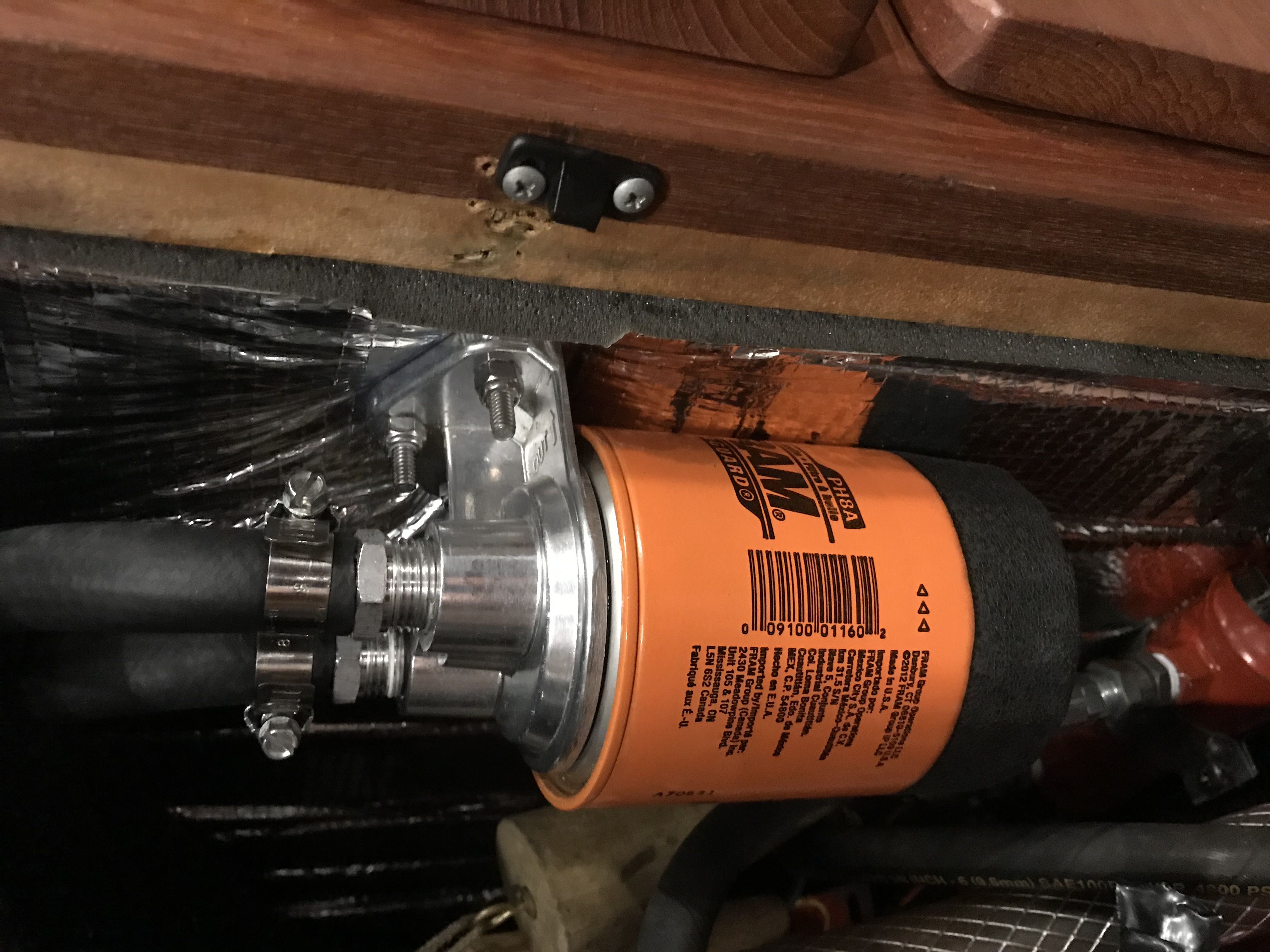

Mary,
I attached photos of the filters on Old Spice and also a pic of the remote oil filter I added. That has saved my back numerous times. As I am 6'5" and do not bend like I used to. It was a kit off Amazon under 40.00. I installed it right inside the access door to the engine. That way I slip a plastic bag under the filter and drop the whole mess and dispose. No more wiping up spills in the bilge area.
