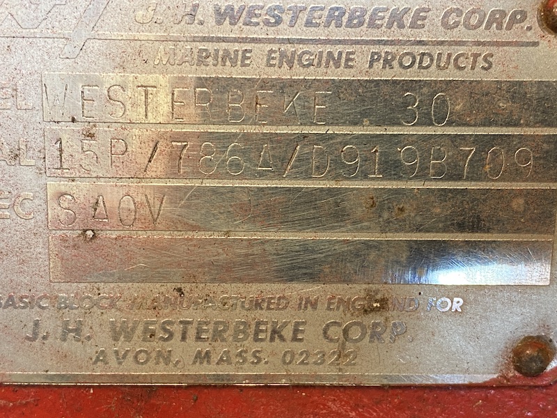

I’m looking for an air filter for my 1978 Westerbeke 30.
Jedsail wrote: Wed May 27, 2020 10:11 am Hello - I can probably help, but will need the exact engine model. Joe DeMers
Hi Joe,
My engine in my 1978 34-III just says Westerbeke 30. It has the V drive. Is that the info you're looking for? From what I can tell, they either came with 2:1 short profile sailing gear or the Paragon V drive.

Hi all,
Was curious if this was ever resolved. I have a '77 westerbeke w30 and am now looking for an air filter as well.
Found a receipt for a Napa filter that I believe is on there now but that one is no longer available and no cross from them. Of course neither is the westy p/n. May try to rig a k&n if there is no other option but have yet to find one that was close. I would appreciate any suggestions.
