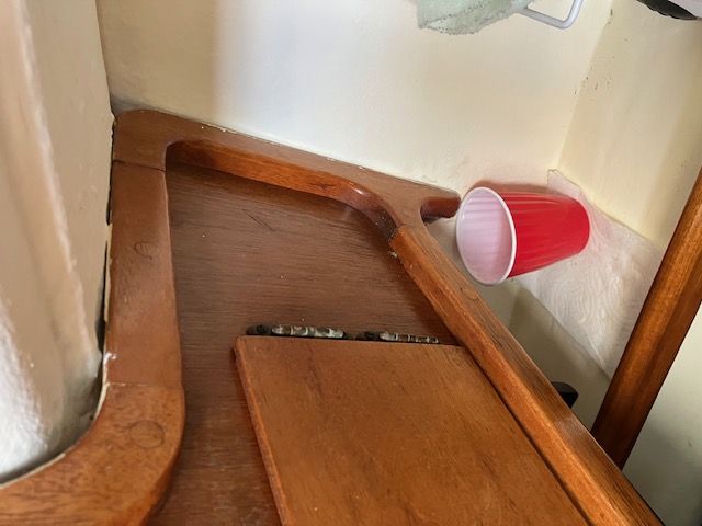

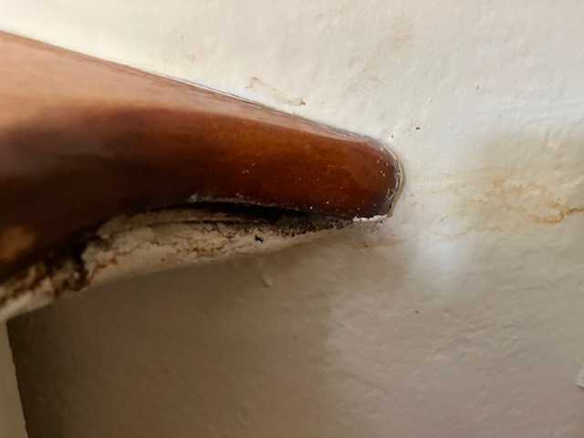

I have not posted in a while. My Cal -2-30 has undergone extensive refurbishing in the last 3 years and I thought I was ok for a while, until I noticed water entry below the port bulkhead. It looks as if the water is coming from the wood sandwiched between the 2 glass sheets. Has anyone experienced the same issue? I do not see any wet areas inside the boat from hardware attachments in the area. Could it be from a bad or leaking hull to deck joint? I have a rub strip all around the boat and don't want to rip it off unless I am sure the it needs to come off. The Cal 2-30 has a gap in the toe rail in that same area. Does anyone know if the hull to deck joint could be the culprit? If so, how do I go about fixing it. You would think the joint does not have any vertical gaps when attached to the hull.

Thank you for your reply. I got to find out why the pictures did not go through. Nonetheless they just show the spot right below the aft wooden bulkhead where the water enters into my newly painted cupboards. Looked at another CAL 2-30 yesterday. The owner showed me where he applied 5200 sealant to stop the same leak in the gap between the rub rail and the toe rail. I have done so thing morning and we'll see if that did the trick, albeit a temporary fix. The rub rail is coming off when I haul out in April. Also a good time to reseal and look at the chain plates again. I have done extensive removal of the core on the stb side and it's dry. Time to go back to work on the port side. Unfortunately that core is a big problem on these old boats. Aside from that they are build like tanks compared to today's yachts where you can see through the hull with a flashlight.
