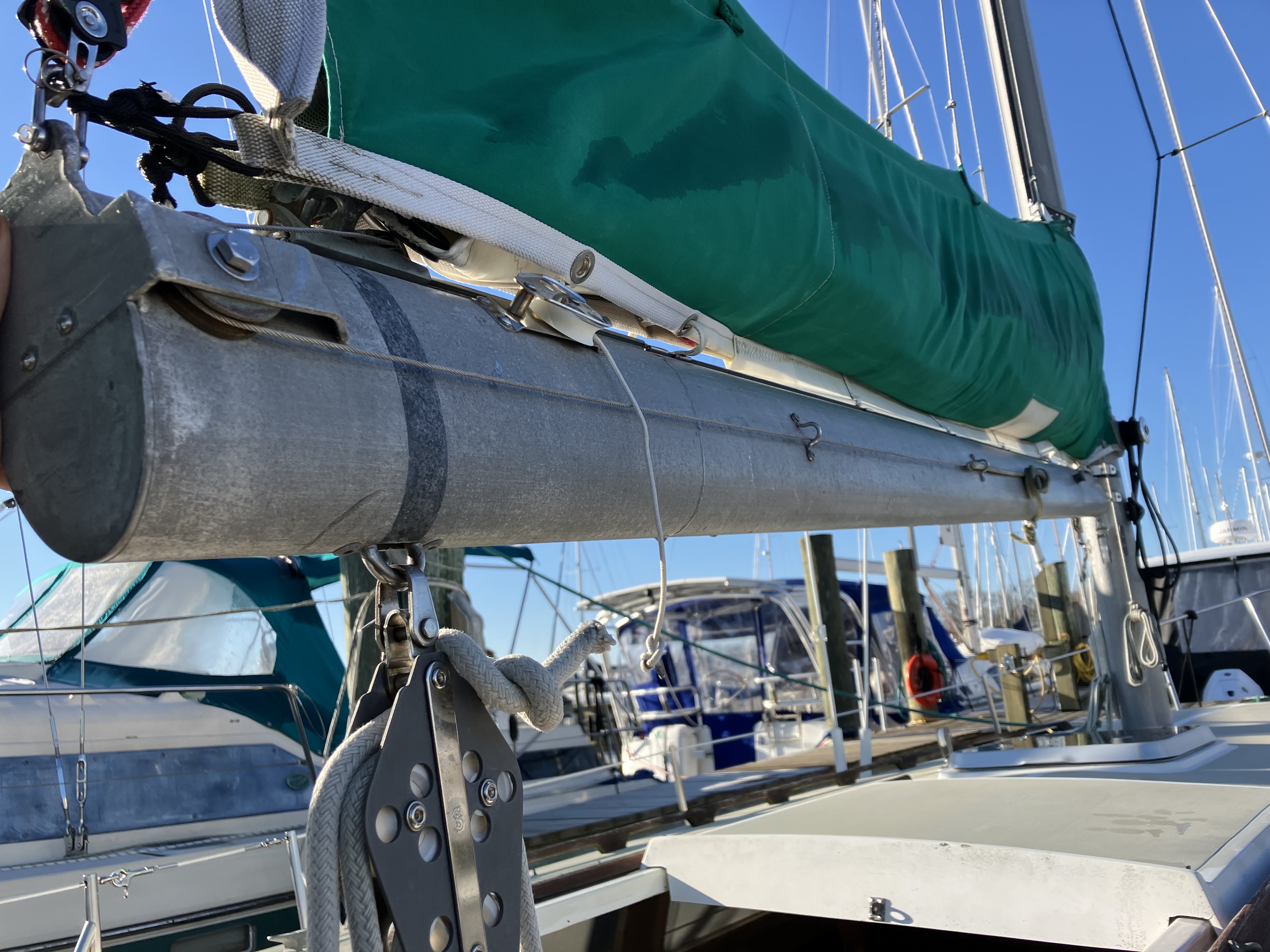

You have a sharp eye, I do not have a boom vang and could probably use one. The boat came with two sails, what appeared to be original wire-to-rope halyards, a mainsheet, jib sheets, a furling Genoa and its furling line, and a few fenders. Nothing else, really. I replaced the halyards with new rope (no wire), and replaced all the other running rigging, adding a topping lift as well. I would LOVE a spare halyard and am considering adding a baby forestay (for heavier weather options).

What I definitely need is a reefing system. My boat did not come with one. Some of the hardware is there but no spare/old lines were aboard, and the PO was a complete amateur, so it never occurred to me what that hardware was for. I have been looking at setups on YouTube but they're only partially helpful. Do you have photos of your setup? My main has cringles for two reefs, but no rams horn at the mast or anything.

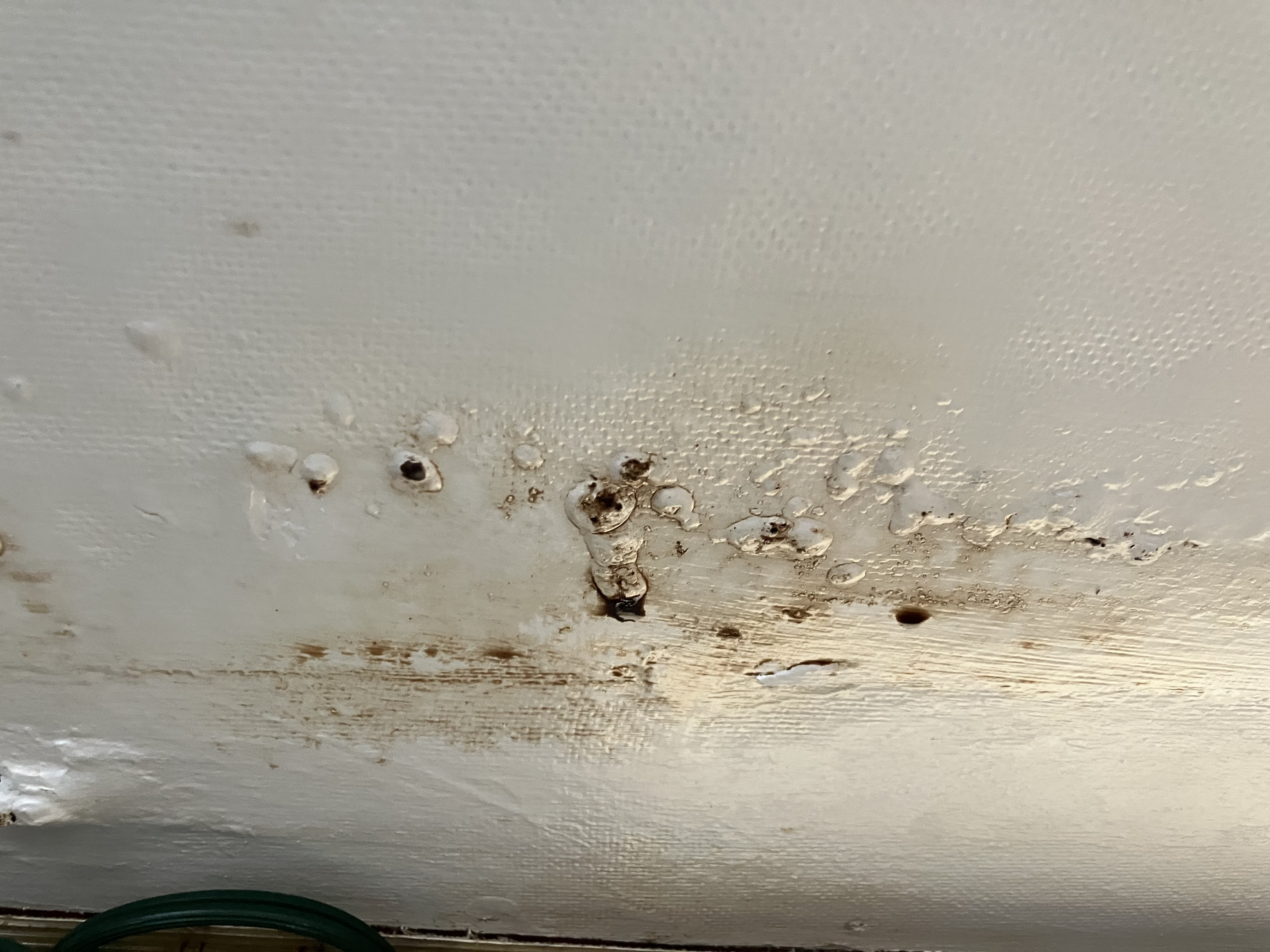

As for my compression post, I have found that water leaking in my hatch pools around the point where the post would contact the cabin sole. That indicates that there is a downward force being applied to the mast or that there was once significant downward force applied to the mast and it deformed my sole a bit. That reminds me that I have seen where the bulkhead attached to the hull by the diesel tank and the fiberglass was not attached.

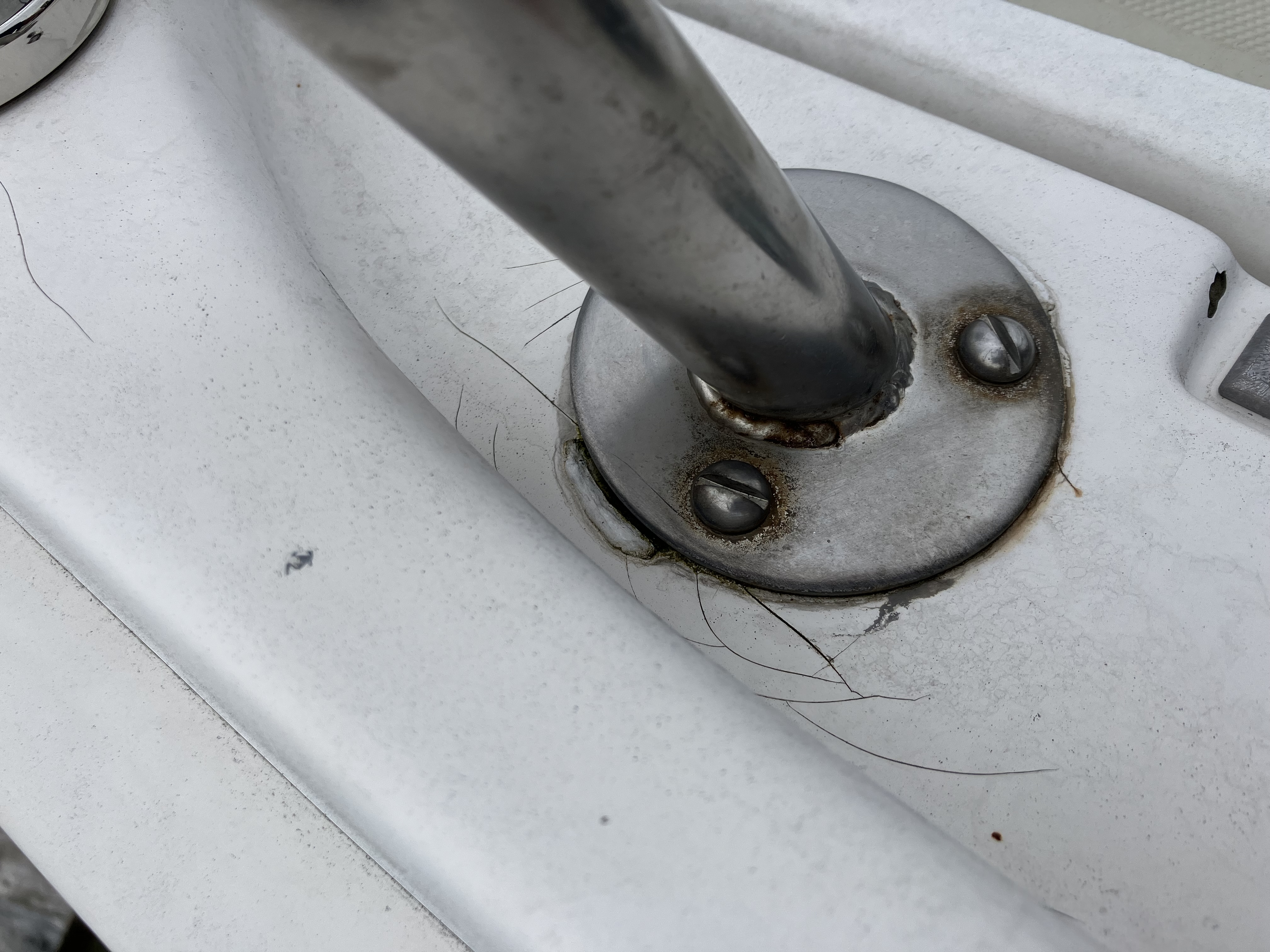

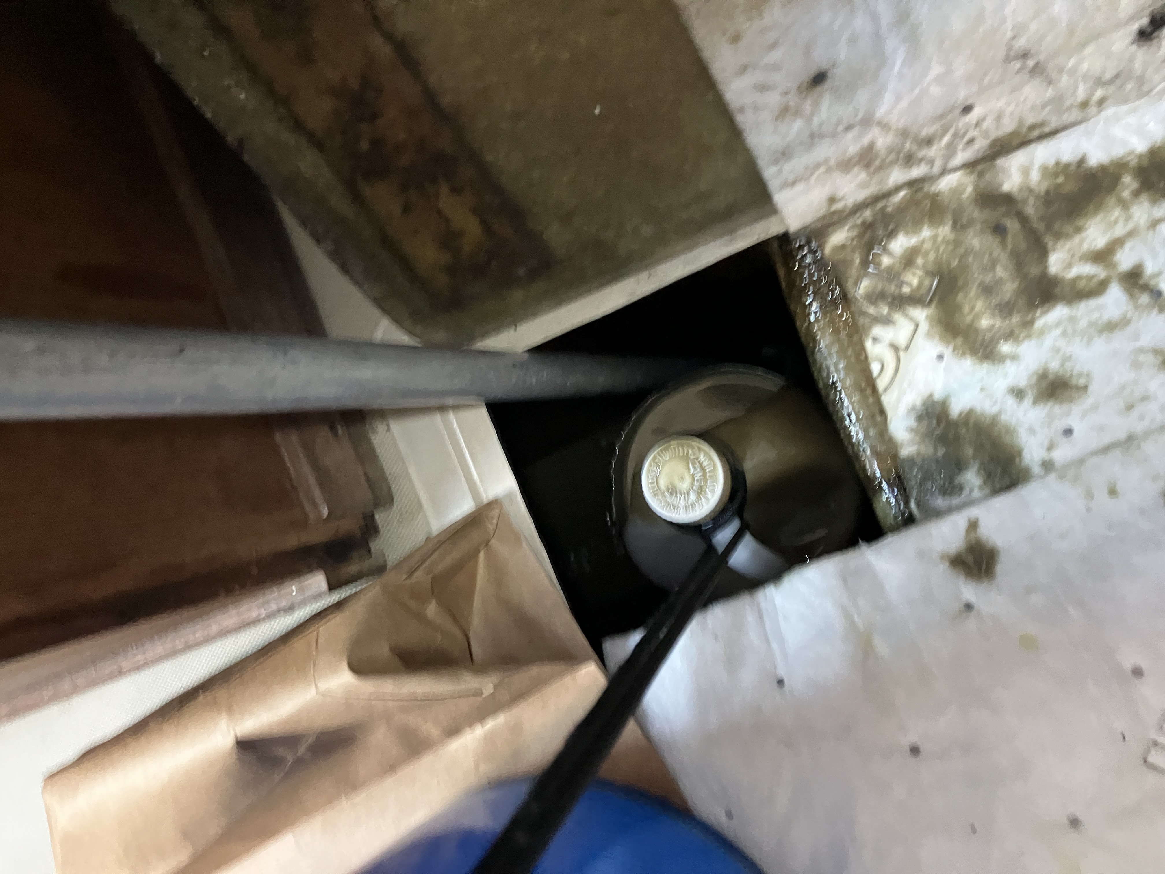

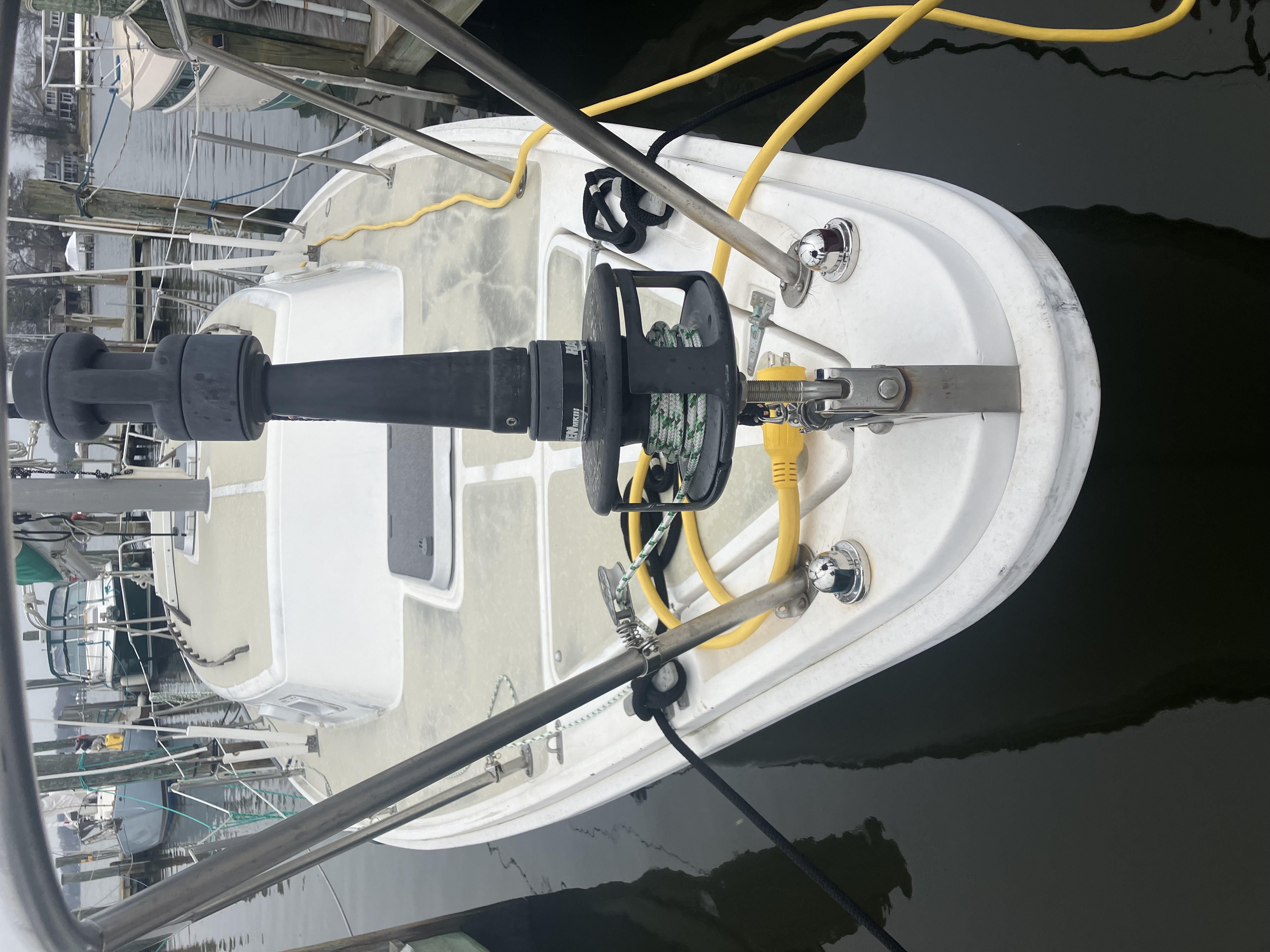

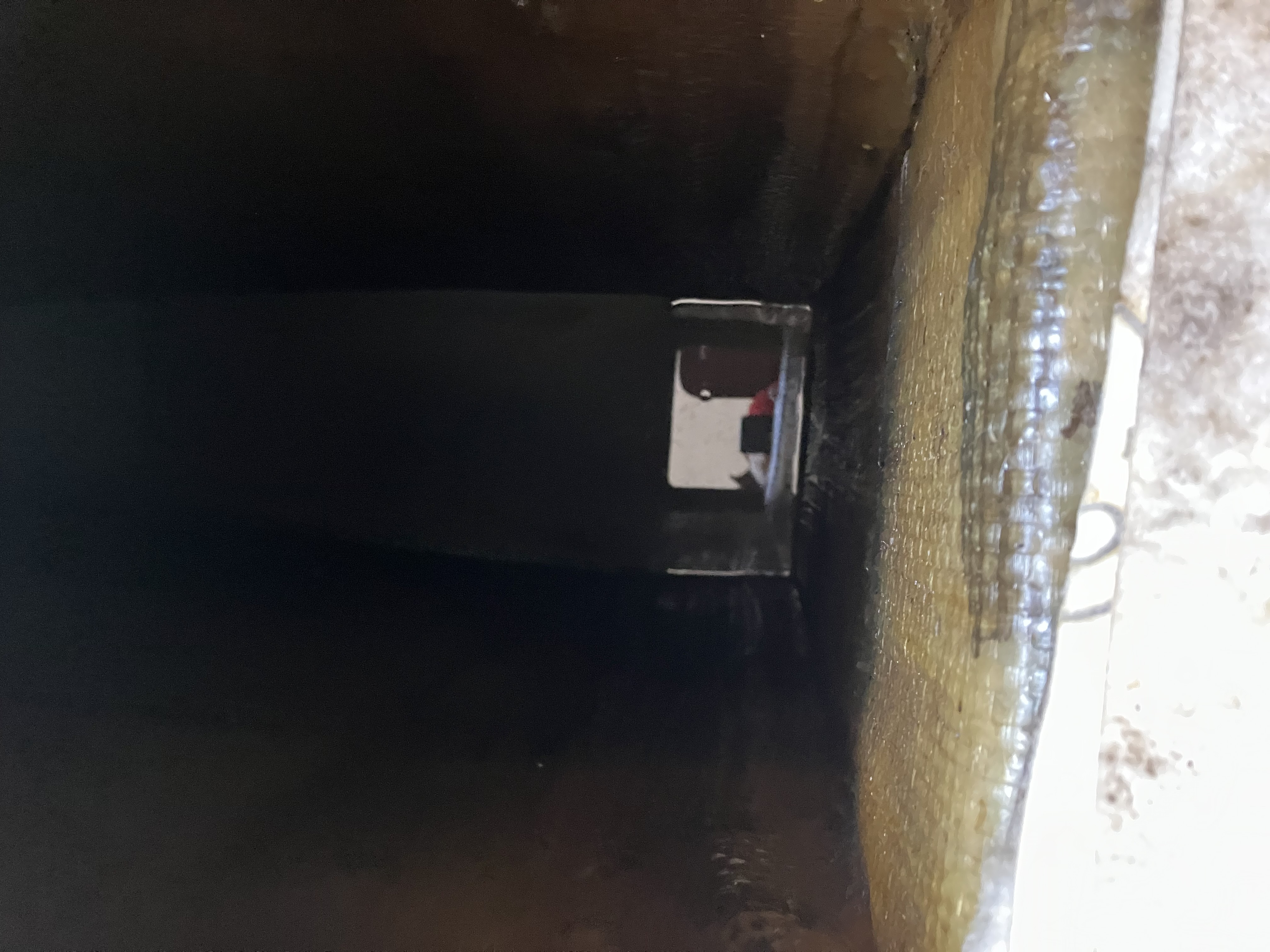

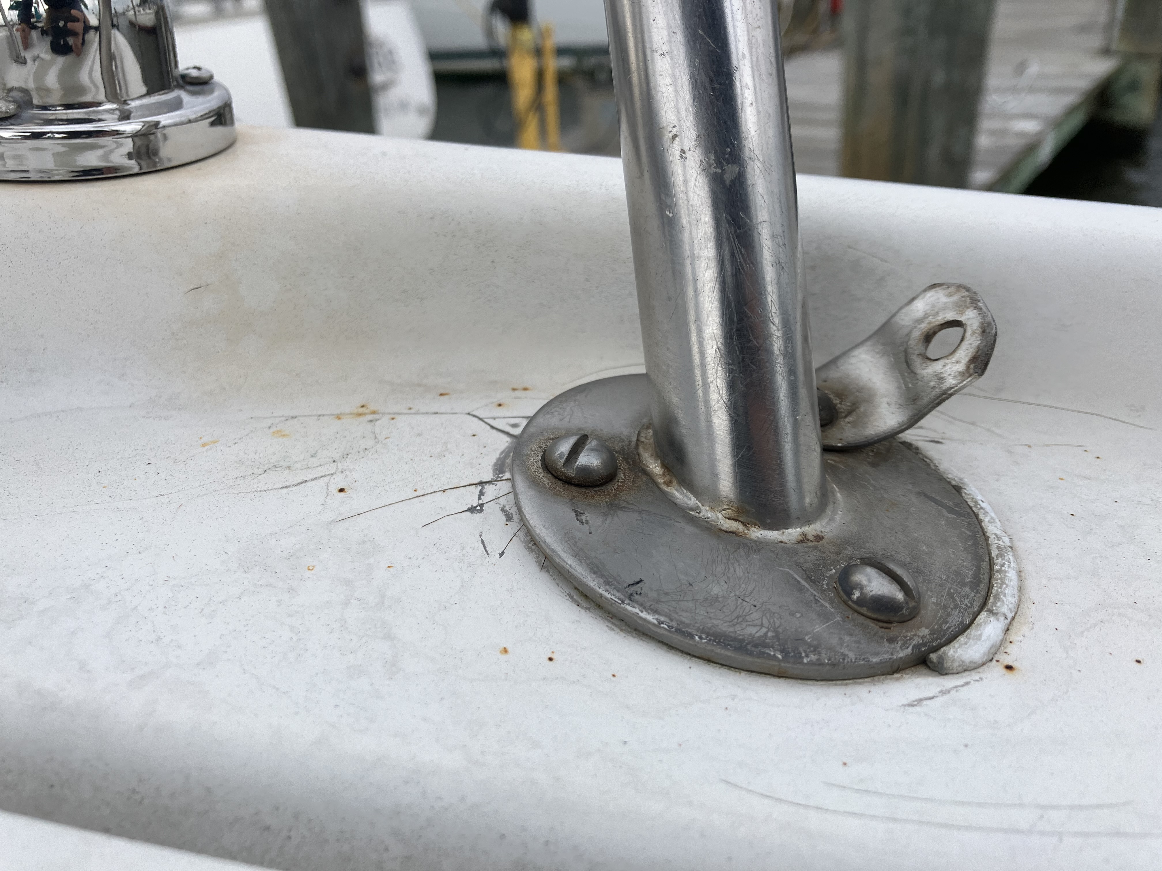

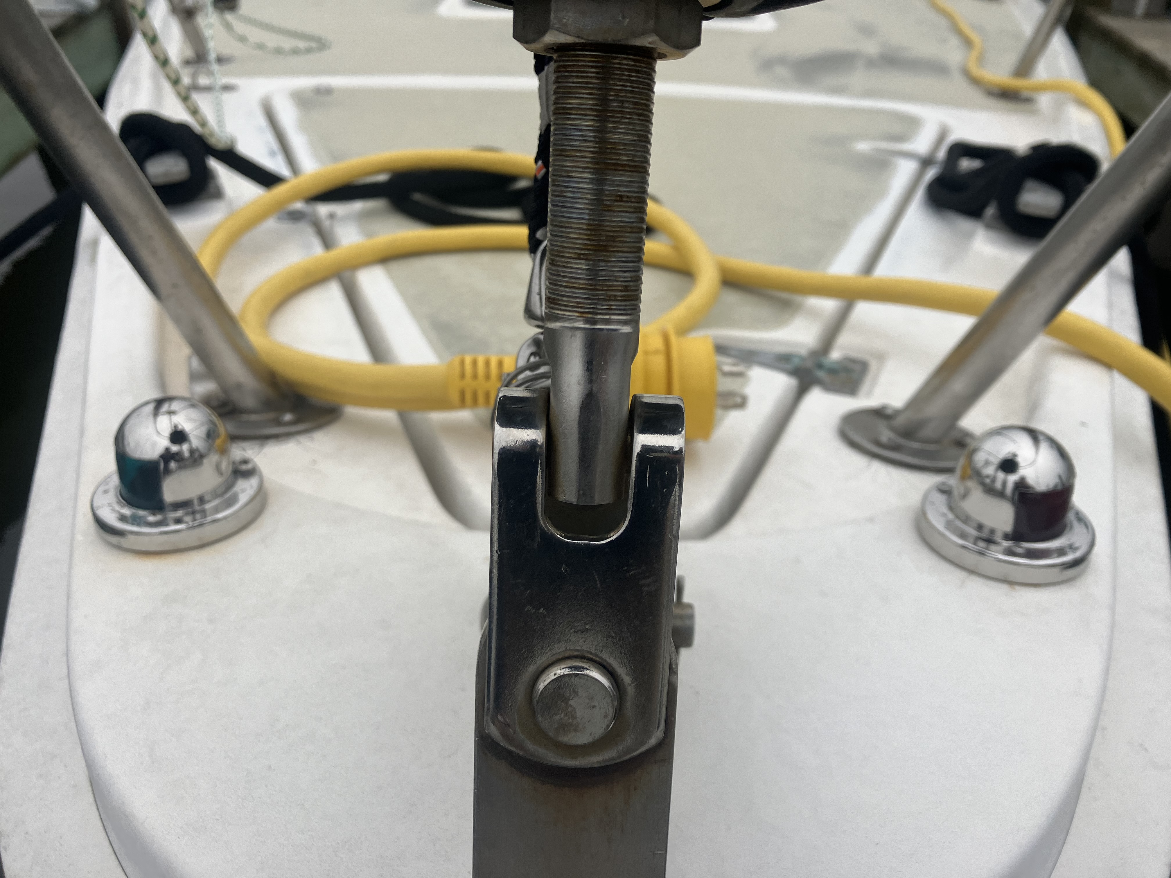

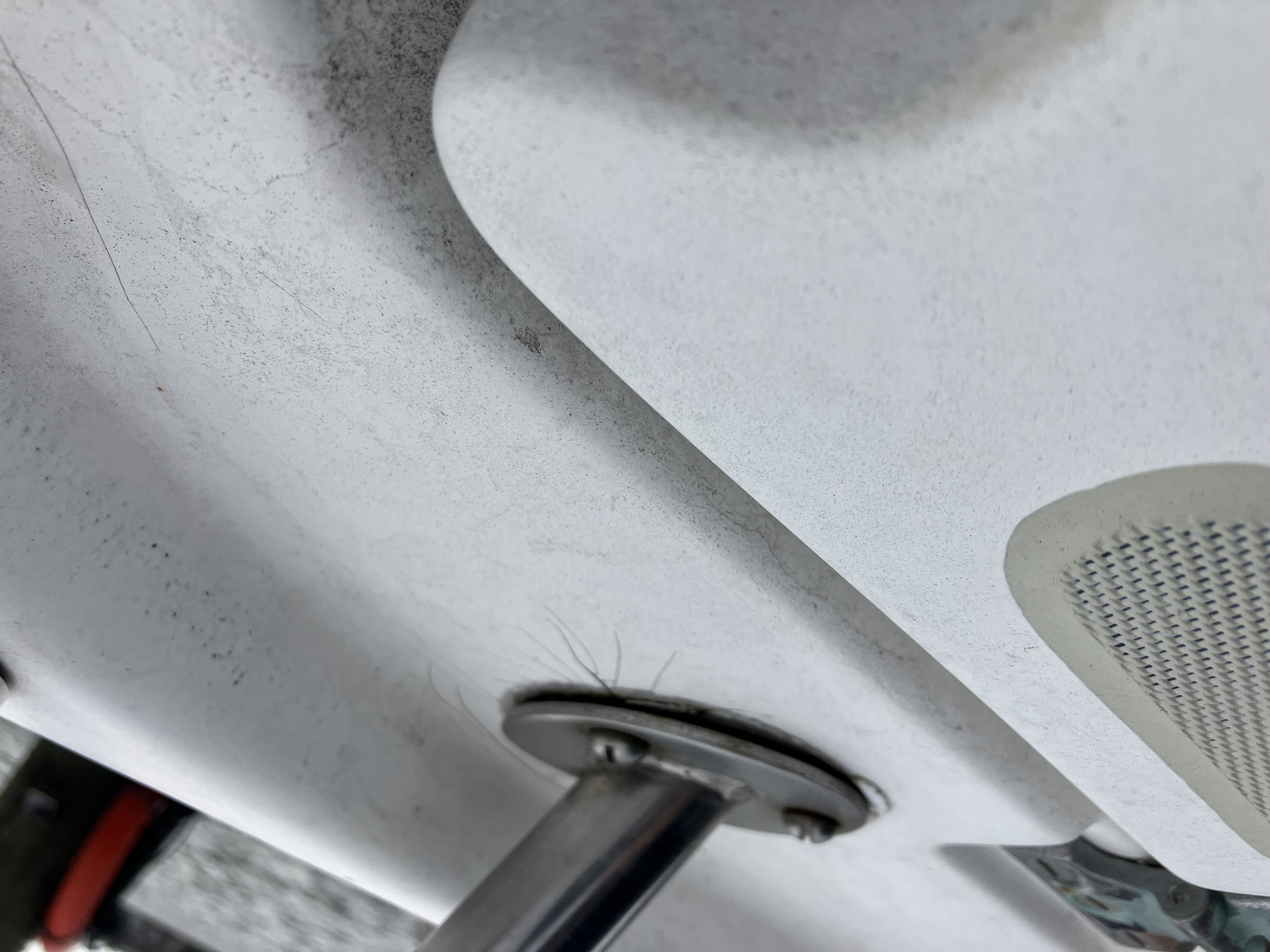

Here are a few photos, particularly of the bow pulpit, boom, and bilge issues I’m working on currently.

Hi Jake, welcome back. You've got quite a list there. I'm glad to hear that you've been enjoying the boat first and then tackling the problems.
I can identify with your black bilges. When we bought our boat the bilges were filled to the cabin sole with a combination of oil, head chemicals, and human waste. So consider yourself lucky if you only have oil. We put all that liquid in new 5 gallon plastic Jerry cans and took them to our cities local recycling and toxic waste facility. Thankfully, other than the Jerry cans, there was no cost and that eliminated, so to speak, the biggest part of the problem. For us it turned out to be a hole rusted in the oil pan. Not a terrifically easy fix but a single source. After solving the leak we wiped off the crud in every location we could reach and then sprayed the entire area under the cabin sole with Simple Green. Lots of Simple Green. Then pressure washed it. We set up incandescent light bulbs in the bilges in multiple locations and left it for weeks. This dried everything out. Then finally painting with Bilgekote of everything under the cabin sole.
As far as your reefing, the first thing is to decide how often you are going to reef. For us we were reefing the main regularly because it was old and baggy. I set it up so that all lines ran to the cockpit right next to the main halyard. You already have a cheek block on the boom and it looks like maybe a cleat forward of the cleat for the outhaul. So you would be set for one of the reef cringles on the leech. You would just have to add another cleat on the boom for the luff cringle. That would set you up for cabin top reefing. Which works just fine but it's a real pain if you're doing it frequently. If you're setting everything up I would strongly recommend running as much as you can back to the cockpit. It definitely makes it less exciting when there's a blow.

Hi Jake, no apologies necessary. I am always falling off the face of the earth over here.
I rigged a reefing system on mine and it works, but I think it could be better. My main sail doesn't slide up and down easily, so it is always a bit of wrestling to get a reef in. I try to reef early because of that. I can send photos next time I'm at the boat. Maybe walk around the marina and see what other people have, too to give you some ideas.
I would be pretty concerned about that much oil usage, and you definitely don't want to pump that overboard. If you're lucky it is just something that needs to be tightened. Check the oil pan drain and oil filter first? Kudos to you for finding the oil dipstick! That took me a minute on mine. It was completely hidden.
In my experience, mechanics don't enjoy crawling around working on old engines. I almost always do better work myself. Did you find the source of the leak?
If your holding tank is working for you, that is great. My boat didn't come with one. As far as the Purasan, I am not familiar with the Chesapeake Bay, but from what I see only Herring Bay is a NDZ. Here's a link to the map: https://www.epa.gov/vessels-marinas-and ... -zones-map
Hopefully the structure is sound with the compression post. Definitely remove the trim pieces around the bulkhead to see what the condition is behind.
