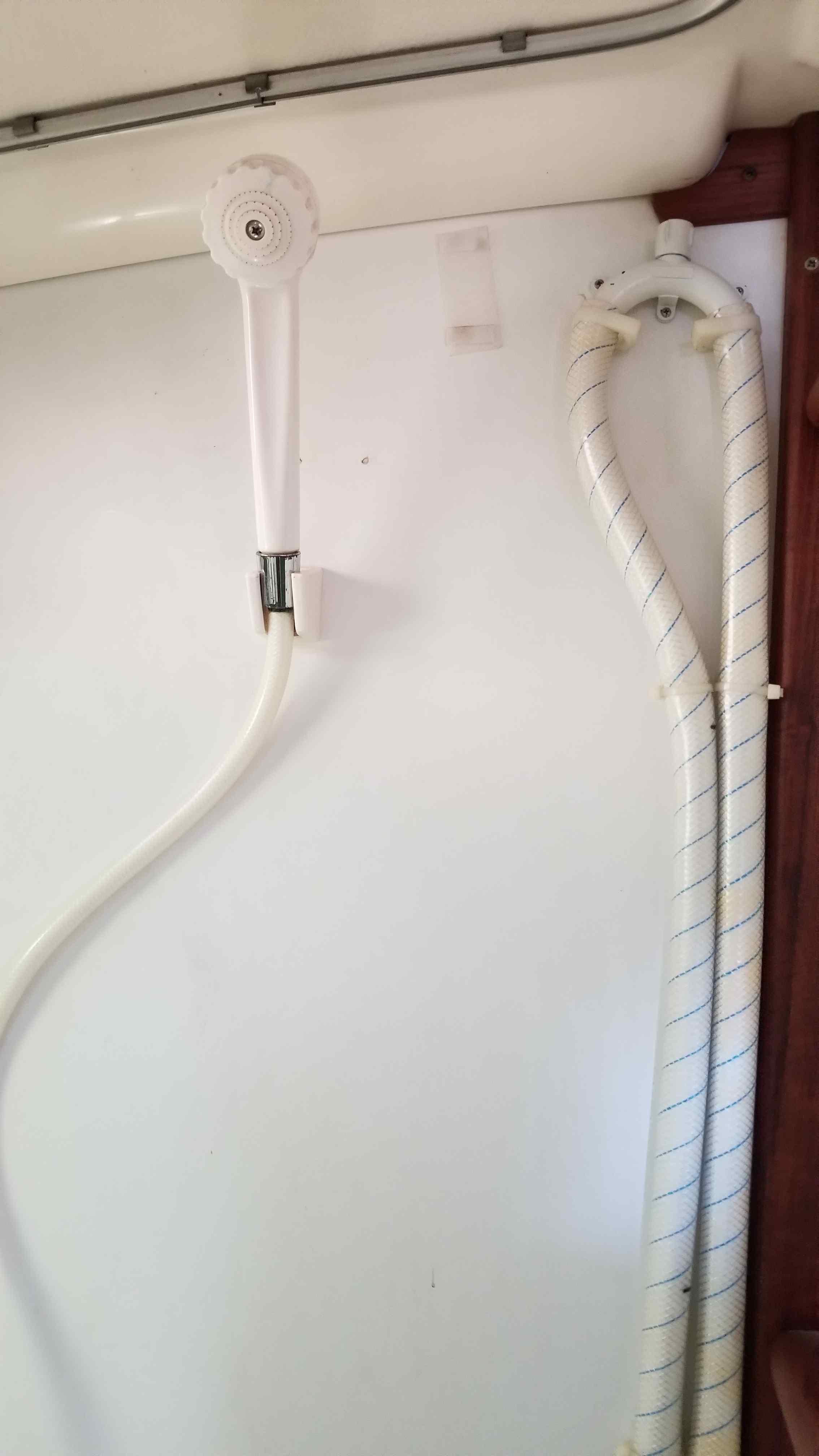

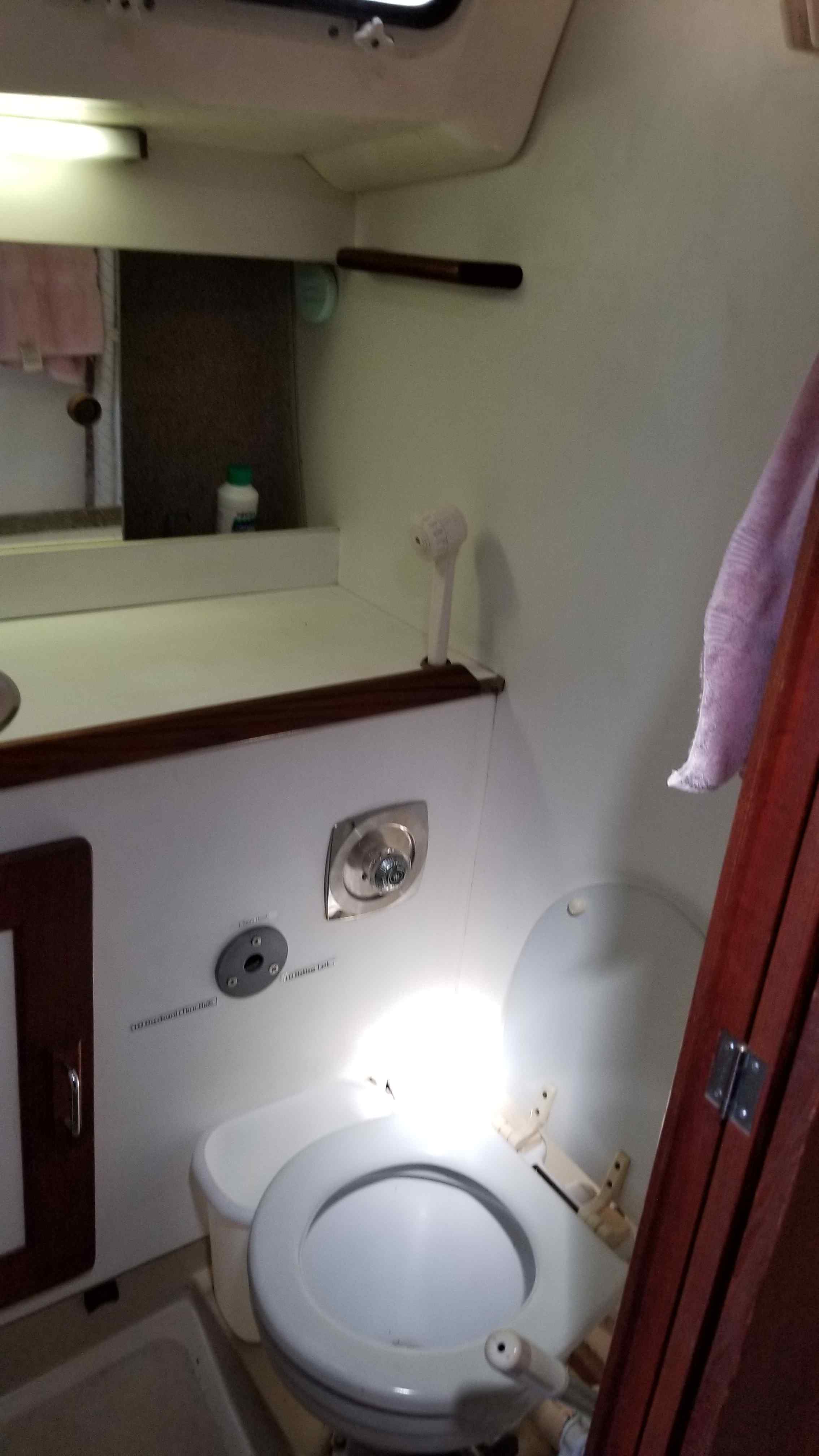

FIRST OF ALL , Is the hot water heater actually usable? My Cal 31 has a 5gal HWH located in the starboard lazzarette that uses the hot water out of the engine fresh water pump to heat and can also heat on 120vac. Running our engine for 15 minutes gets me a full tank of hot water at 180 deg F. I ask - Why was the HWH disonnected? Maybe because it leaked....
Our shower is shown in the pics attached. We do not use a curtain; but are careful where we point the shower head when on. The mixing valve is shown in the cabinet wall. Note the hand-held head has a on/off control right at the head. Very useful to conserve water. Agreed on the shower curtain set up! We just wipe down the Formica and teak afterwards. The vented loop next to the shower head is for the head flushing sea-water, not for the shower.

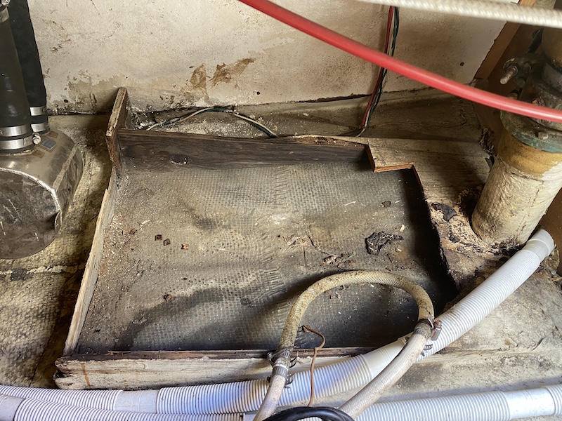

The water tank is a “new” unit, meaning someone put it in there before I owned it. It looks like it has never been hooked up or used. I just found it in the lazarette. There is a place aft of the engine where the old one probably used to sit. That unit doesn’t have an electric water heater built in. I looked online and the electric + heat exchanger unit is $1000!

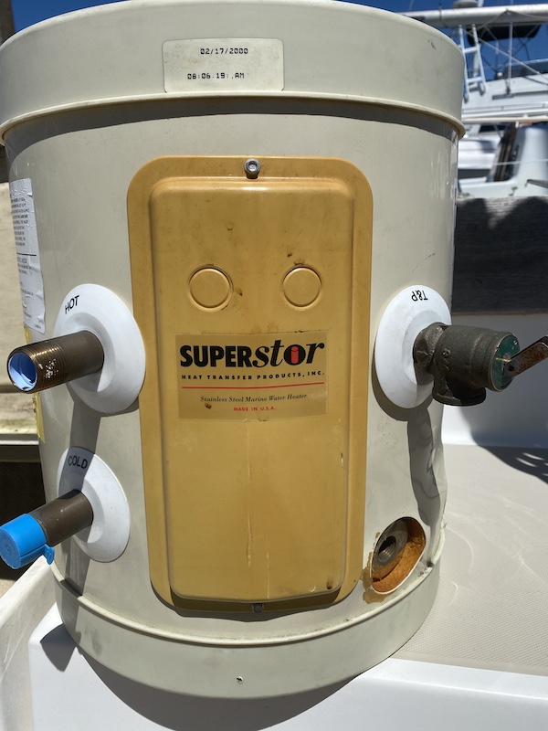

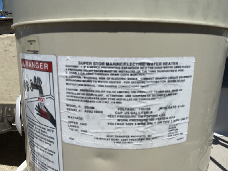

I dug out the hot water heater today and realized that it is in fact a water heater. Just have to get around to hooking it up. The boat needs new fresh water hoses while I'm at it.
